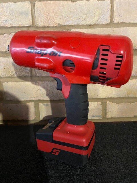

  8. Turns out it just needed a bit of encouragement
  9. Just what I used, did the job eventually.
