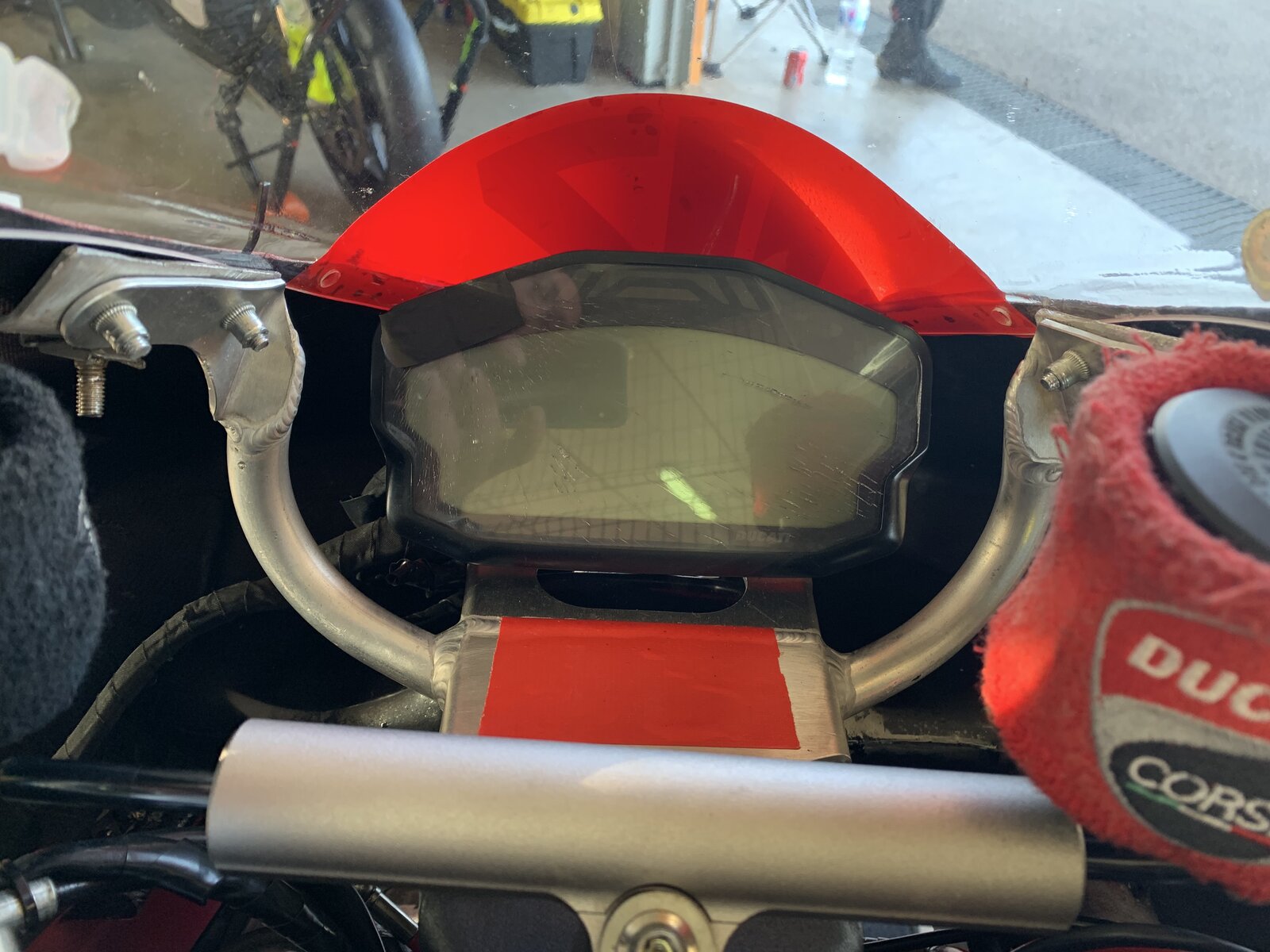

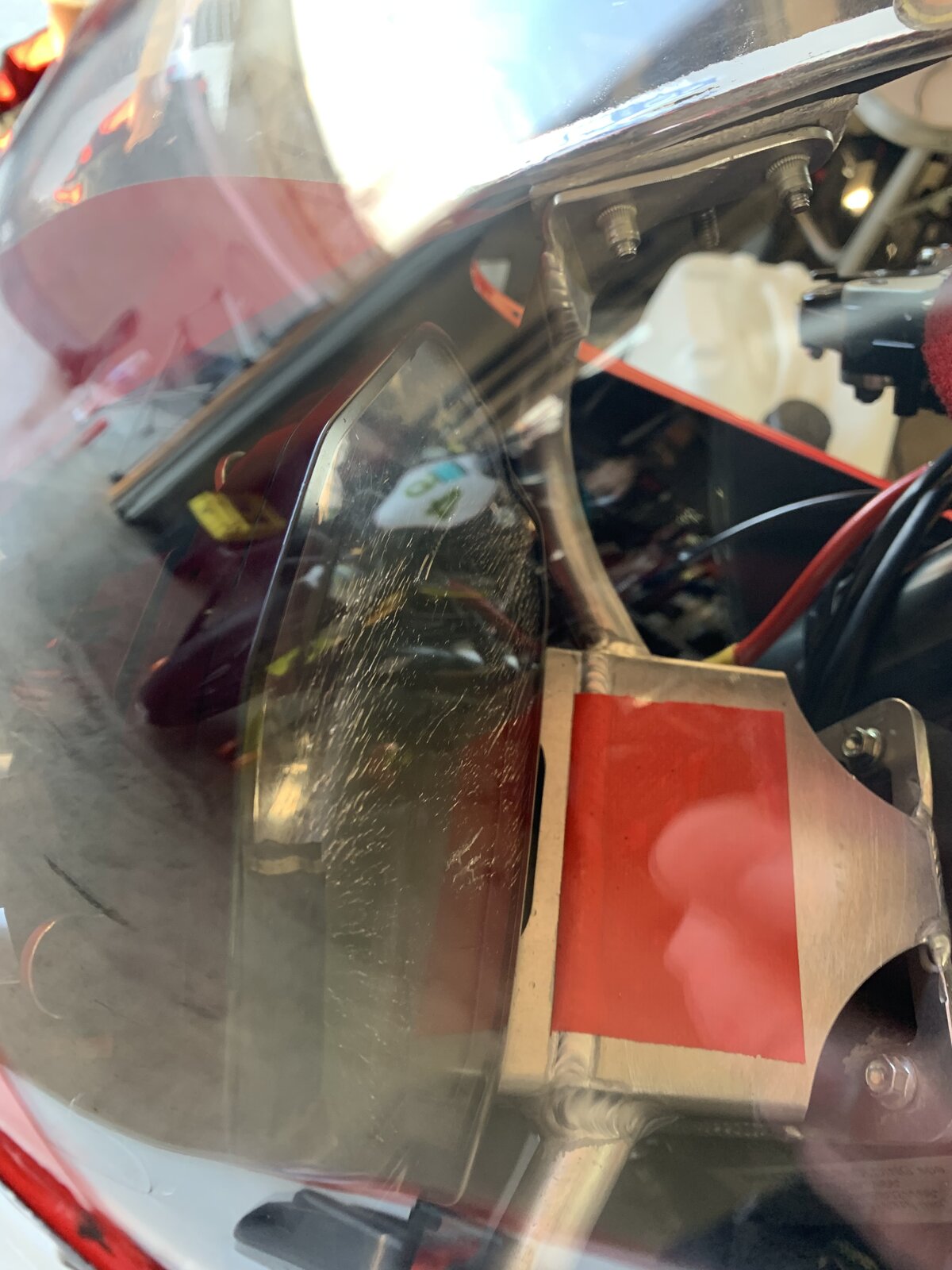

  1. So having had this issue on a new 1299S a couple of years ago replaced under warranty I’m here again... this time with a 2014 (well out of warranty) Ducati 899 with a beautifully shattered dash screen.
    Has anyone successfully got the dash unit apart to replace the front cover? Thinking heat and a plastic prizing tool
    If I buy a second hand dash will it display my mileage or the mileage of the second hand dash? (Anyone with first hand experience as a lot of mixed opinions out there)
    Anyone selling an 899 dash?
    Pictures for your amusement

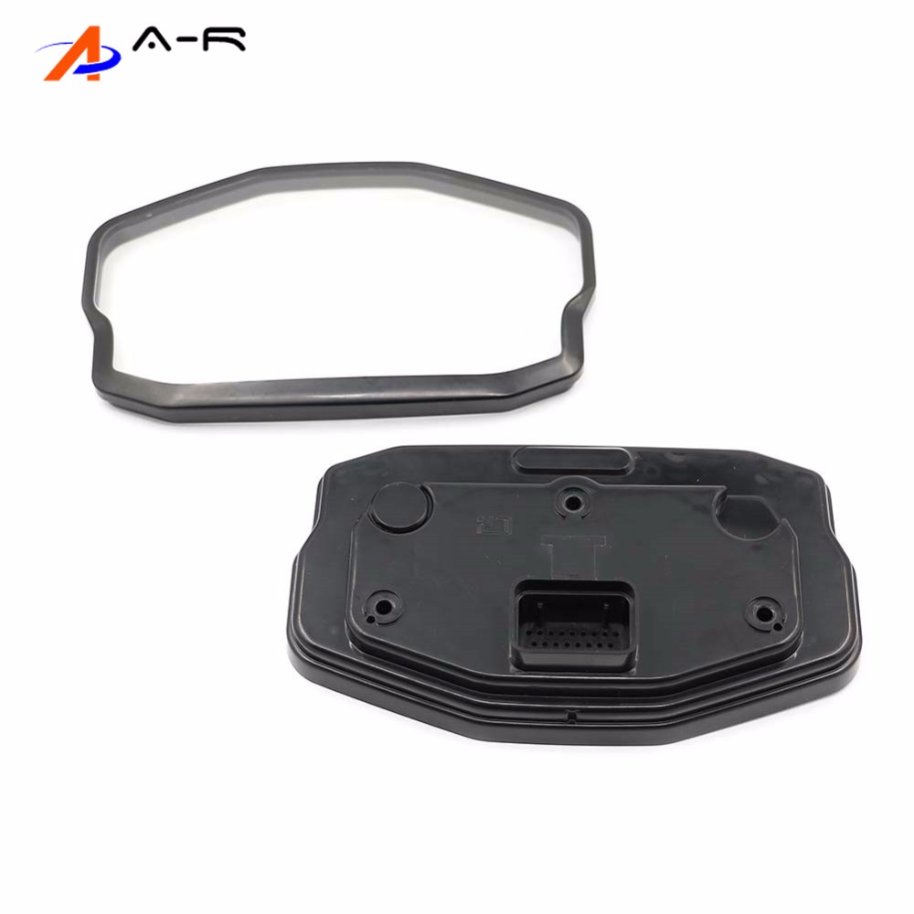

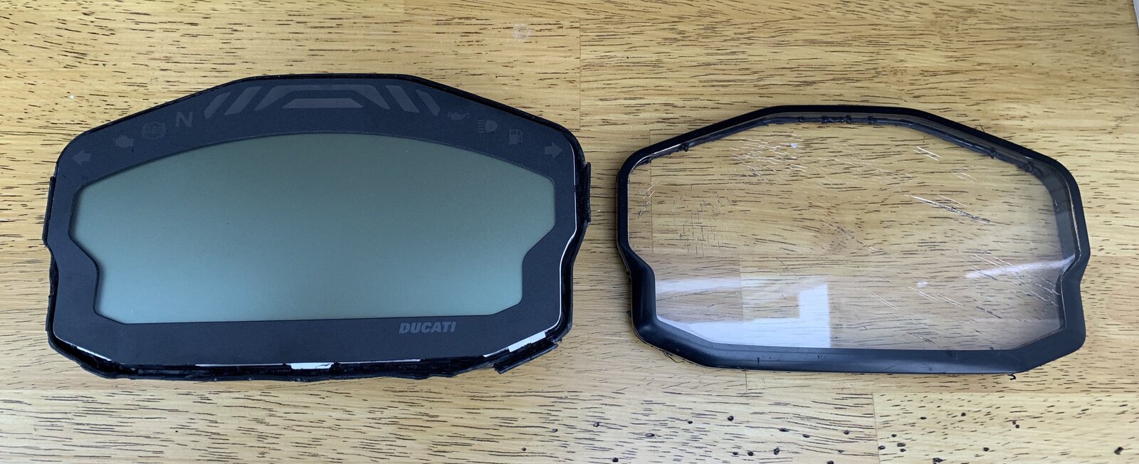

  10. Well with some heat, a butter knife and some force work you can get the units apart.
    Called local Ducati dealer who had no suggestions on what to do nor would Ducati replace the unit with the bike being nearly 5 years old.
    So I’ll see if I can find a good condition second hand unit to see if the mileage is stored on the device or the bikes ecu and maybe try and repair mine if it’s on the device
