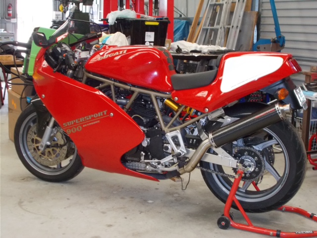

  1. I got a spare fairing and the single seat painted and used Imageworks for the decals(really good to deal with and great quality).The bike has also got a set of 800ss Marchesini wheels, an ignitech ignition module, ergal clutch basket and Oberon slave cylinder recently, so I'm pretty pleased with the way it has come out.:) DSCN2116.JPG

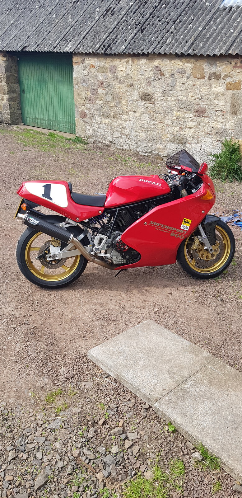

  2. Beautiful:upyeah:

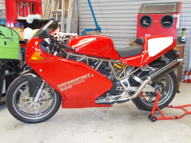

  3. Lovely, that's like the route I went down, and the money I saved sourcing a true Superlight was used on mods! 20180526_104018.jpg

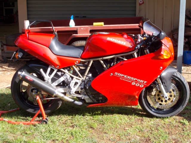

  4. Lovely bikes guys. I need to get a carbon mudguard for mine . Any recommendations?

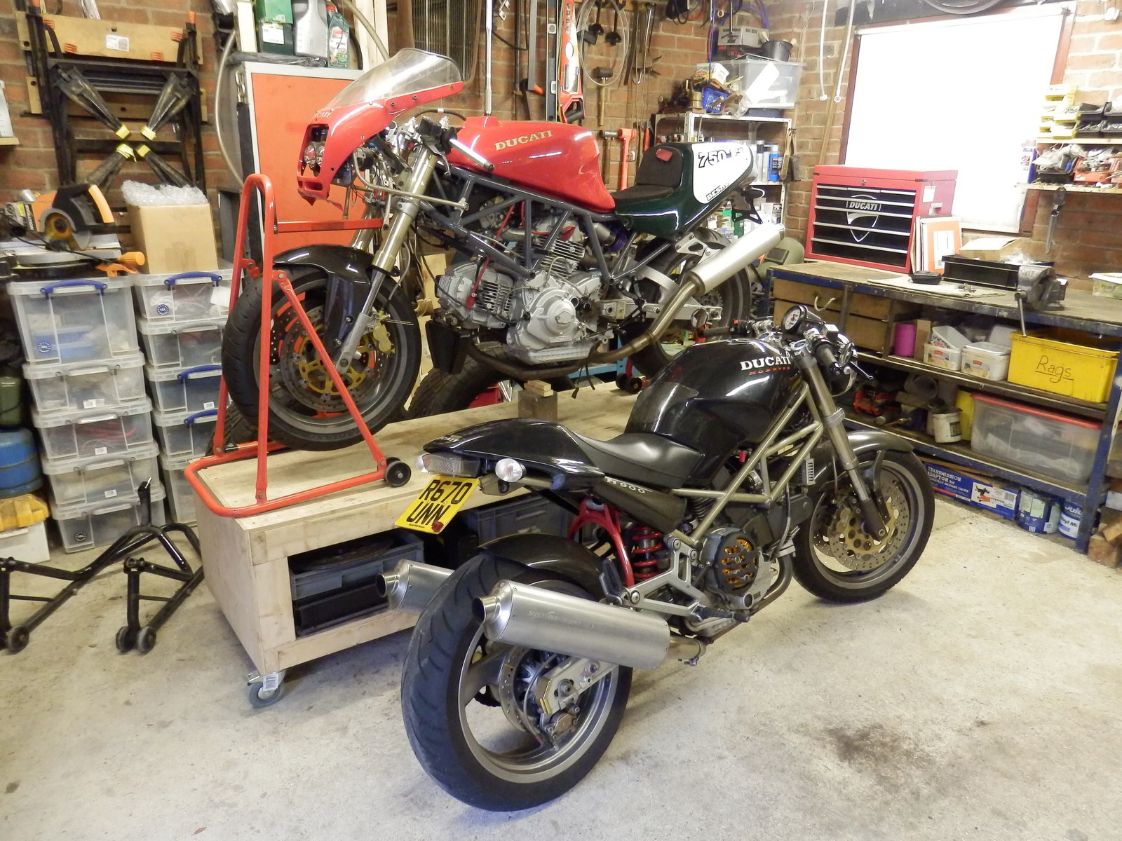

  8. I’ve used a Ducati Performance Carbon Front Guard meant for I think a 996 on my 900SS/semi-Superlight/Mongrel I’m putting together.
    Just visible in the image attached. Obviously the bike is nowhere near finished, ignore the secondhand seat unit that still needs painting.
    There is a much larger choice of Carbon guards available for the later bikes, and it’s really simple to make a set of brackets to convert the early bikes closely spaced mounting holes on the forks to the wider spaced holes of the later bikes. The brackets are fully hidden so can’t be seen.
    I’ve done it on both my M900 and the 900 Mongrel, but I suppose it depends on how accurate you want your replica to be.
    I’ve aslo converted the single seat unit so it can be lifted on and off with the key to access the storage space underneath, which I think is a real Form over function stupid decision Ducati made with the standard seat unit.
    https://www.ducatiforum.co.uk/threads/images-wanted-ss-with-non-standard-seat-units.50464/
    And chopped the mudguard back.
    https://www.ducatiforum.co.uk/threads/ss-rear-mudguard-chop.54488/

  9. The ss wheels look the part, are they a straight swap?
  10. The rear wheel is a 17mm axle so that is a straight fit, but the front on this '93 model has a 17mm axle. The 800ss wheels had 25mm id bearing so I had to make spacers/reducers to make the fit. I thought we may be able to bore out the bearing pockets in the wheel as 47x 17 x14mm bearings are available(800ss use 47 x25 x12mm) but there was not enough material. Also the speedo drive is then a few mm to wide so that had to be trimmed. But nothing drastic!! You can't see it in the photo but I floated the rear caliper like a real Superlight(photo before the new bodywork/cans/wheels etc.) DSCN2073.JPG !

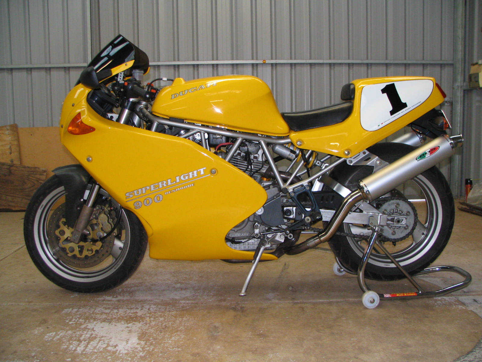

    This one is actually from NZ, mate of mine bought it new over there and bought it with him when he came to OZ, then sold to me 5 or so years ago.
    Wasn't running and a bit rough round the edges when I got it and has a bit of an interesting past having had fuel injection at one time.
