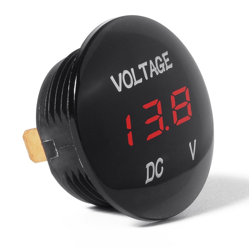

  11. Yes thanks, I agree it's got to be worthwhile. Should be able to find somewhere to stick something like this out of the way but visible, kinda no-brainer for a fiver:
    http://amzn.eu/jlcmsDg
